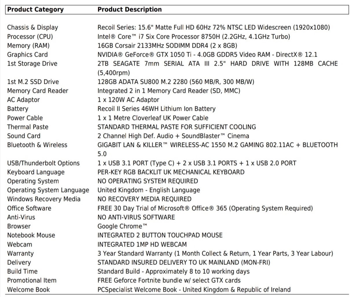

Is this a PC Specialist build? Can you post the full specs from the order page please.
Via Tapatalk
Thanks.

How do i remove the battery for the recoil 2 laptop? Ive taken the back off
So i disconnected the battery from the main board, held down the power button too and this hasnt fixed the issue, neither did the new windows update
