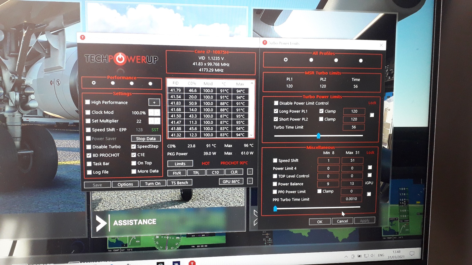

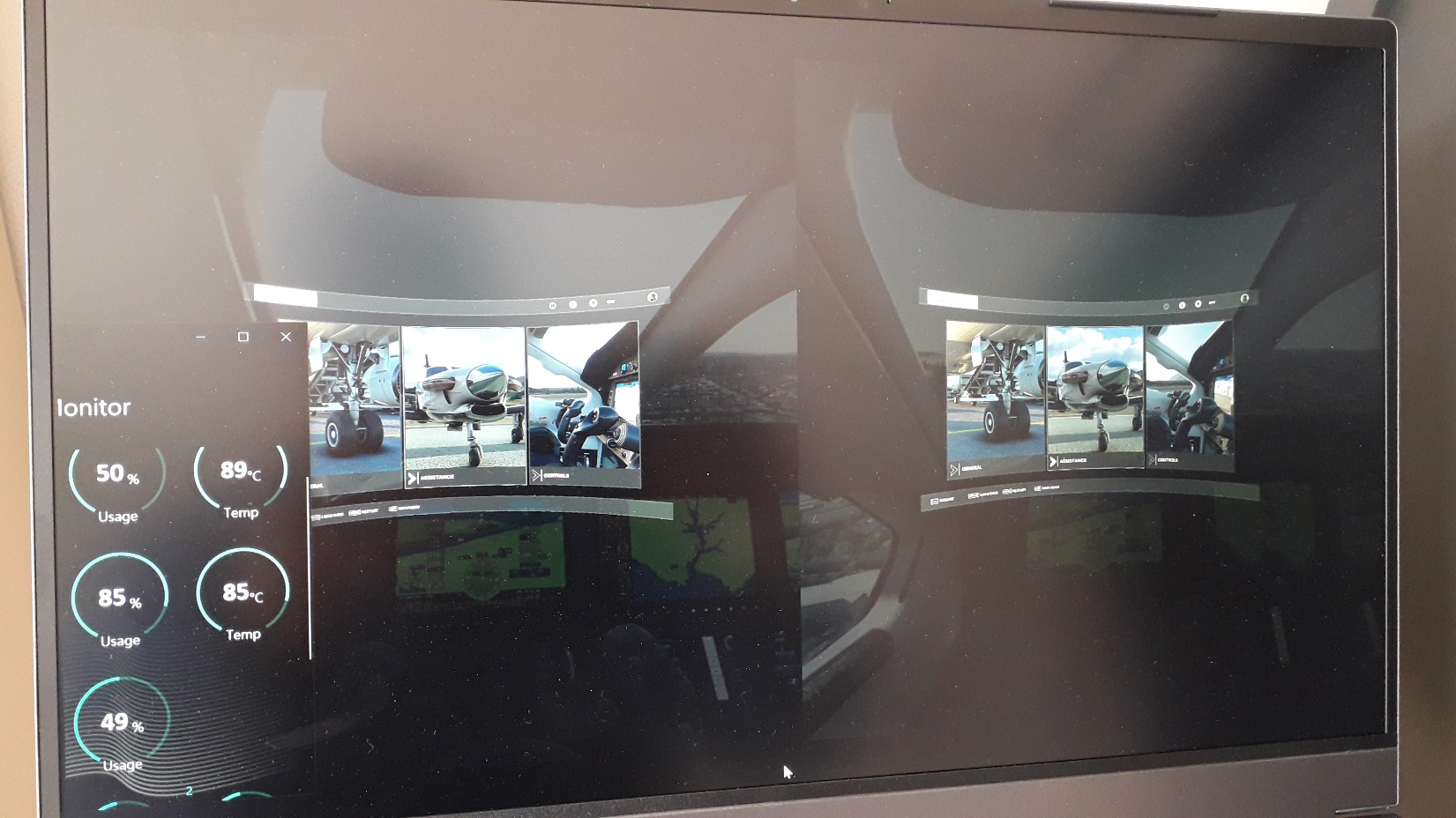

Earlier stress tests suggested my thermals were good (I should repeat). I have been recently playing MSFS20 in VR. Thought I'd take a look at temps today and was surprised. See attached pics.
Clearly CPU thermal throttling but at only 45% usage???? Why is that?
Have I caused this with the Throttlestop settings?
What's the best advice?
Note CC pic, upper is Cpu usage/temp, below Gpu usage/temp.

Reset the throttlestop settings and retest. It’s likely you’ve overclocked either by accident or intentionally, you really can’t overclock a laptop cpu at all, the cooling can’t cope.

Thanks. I undervolted in TS. But then set power levels as well without fully understanding what I was doing. I will reset.

At the risk of sounding patronising do not change any settings in Throttlestop if you don't fully understand them. You can legitimately fry your components that way.

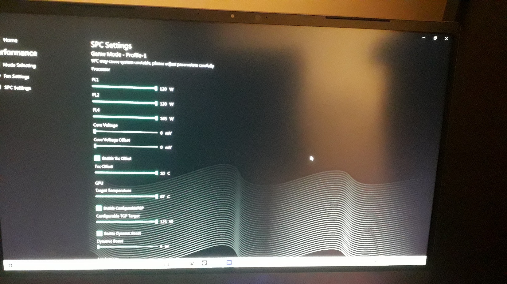

Dropping visuals to min levels in game, oculus and OTT does not help (pic attached). Boosting visuals to very high to force it to be GPU limited (or at least putting more strain on GPU than CPU) drops CPU to 85degC ish.
I maxed the CC for gaming (pic attached) and believe this to be the next issue, can anyone give me a sensible set of values for gaming? Thanks.

I think your high PL is causing this.
In Throttlestop don't touch much but the undervolting (which can only lower temperatures).
PL in the CC at 120W+120W can't be a sustained thing. Those are values just for a brief benchmark.
You'll reach eventually your Tcc limit.
If you limited your CPU at 35W or 45W max, you should avoid throttling.
Edit also 49% CPU usage, but like with 2 cores (out of 8) pushing at 5.1 Ghz and some others at less isn'nt really that less hot experience than you think.
Base on the PL, not CPU%. Power (W) is always proportional to heat. CPU% not so much (too many variables in a 8 cores CPU).

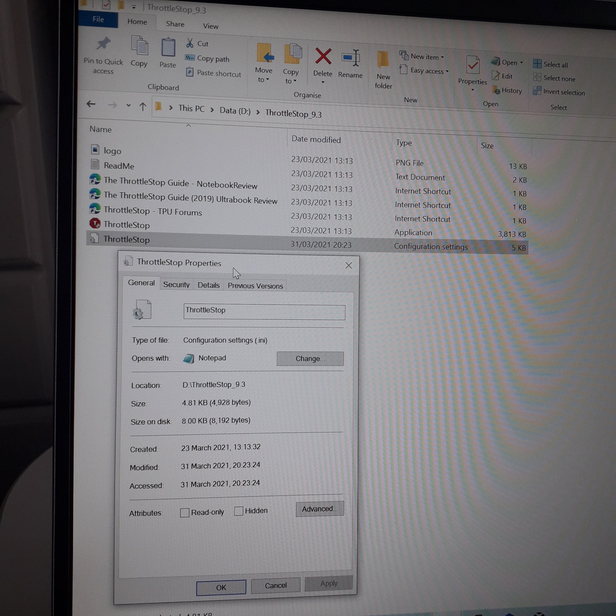

Thanks, how do I do that if you dont mind me asking?
I was nervous about a CMOS reset. After I received the laptop I swapped windows from the 1Tb to the 500gb drive by cloning with Macrium. I was not sure whether a CMOS reset would point it back to the 1tb drive where there is no longer a copy of windows? I had to change the drives in the BIOS.

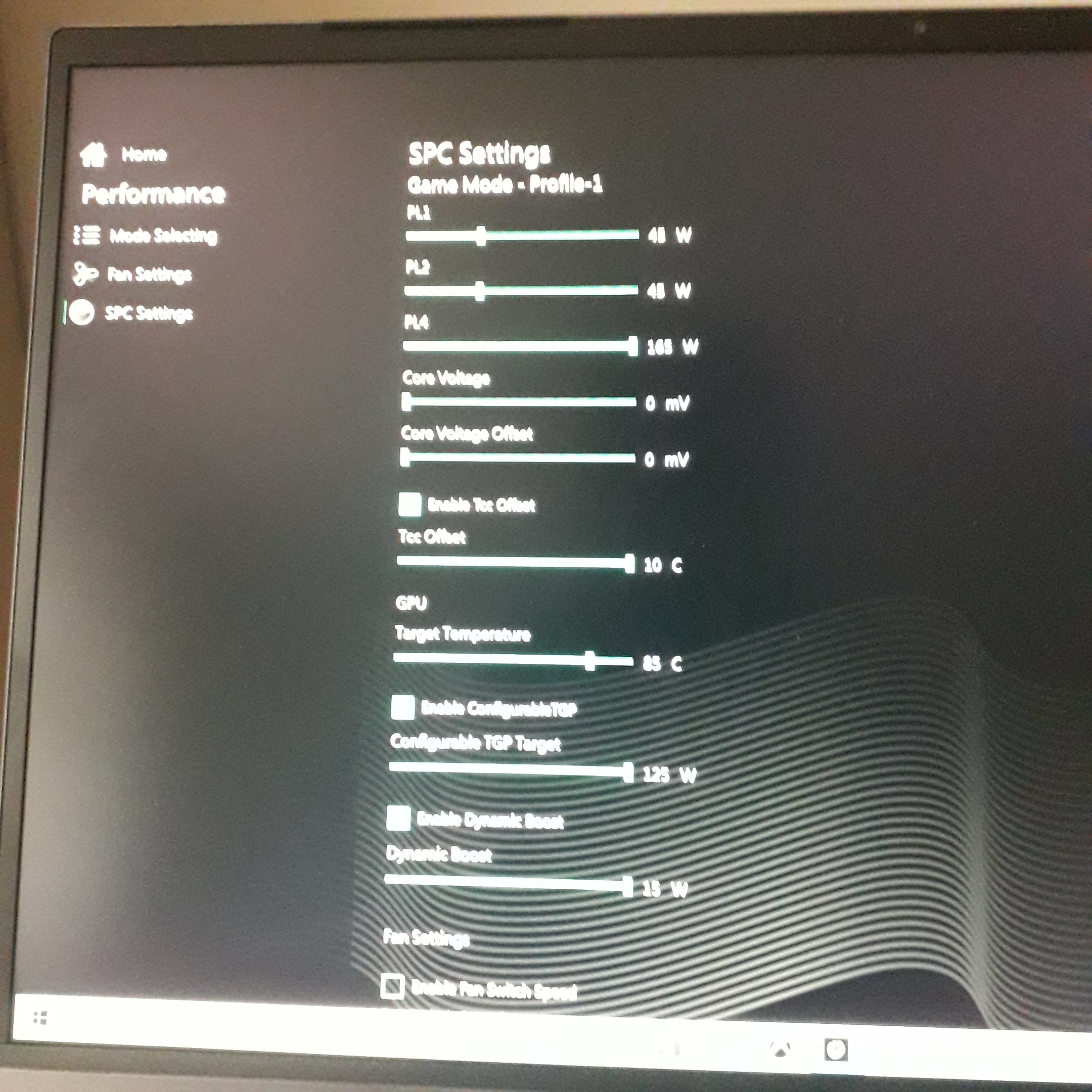

Thanks. If we ignore TS for a moment, are these good CC settings for sustained gaming?

Any information of TS are in its .ini file. If you delete it and, for extra safety, reboot and relaunch, it will start afresh.
About the CC, seems ok. I wouldn't bother with GPU Temp limit. But CPU PL seems solid. Depending on the game you could also drop to 35W. More W to the GPU thanks to Dynamic Boost, but it really depends on your game's demand if successful.

Because TS implements the changes at an OS level and doesn't write to the BIOS there for a CMOS reset is not necessary.
*edit* Definitely read your post wrong and answered the wrong question. Just uninstall TS. That should do it.

Ref TS I will delete the .ini file.
I would quite like to keep it as an option for undervolting only, once everything else is up and running to see if it lowers temps further? I have taken it out of task scheduler so once reset I presume it will do nothing unless I launch... is that correct.

Without anything in its .ini file it will just monitor your wattage, temperature etc. as it was an HWinfo64 sensor monitor.
