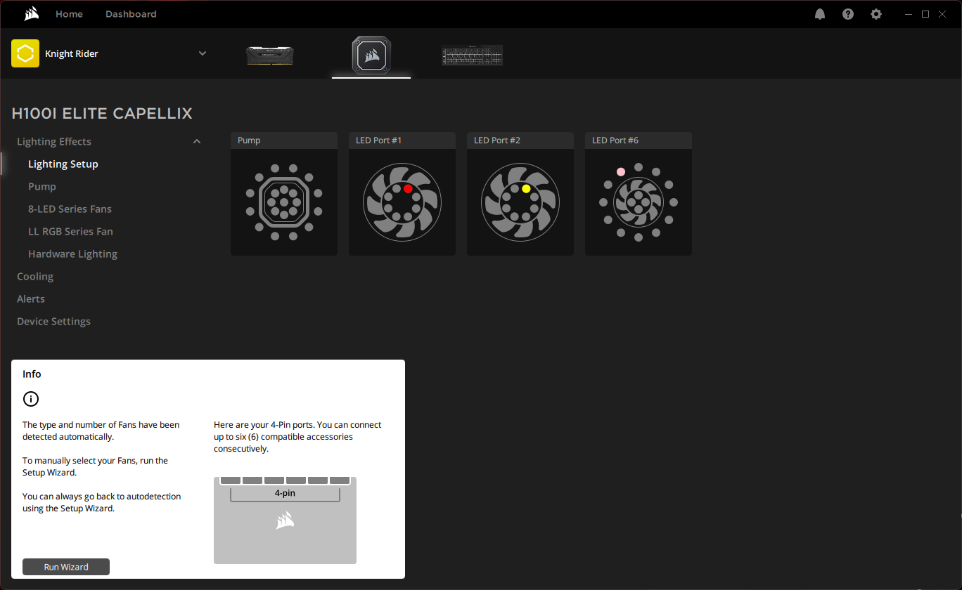

Ok I got a LL 120 and plugged it in, here's what Icue shows.
Port 6 is the LL and you can control fan speed & RGB on each fans separately, you have to run the wizard when you install new devices but it's looking good and now seems to handle mix and match very well.
