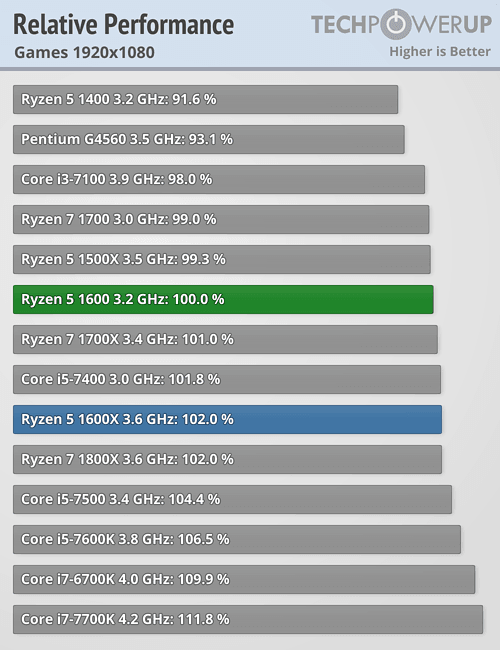

For gaming it's better value than the i7 7700k in that it's cheaper and it will run games. But its performance is less, sometimes by quite a lot. That's not to be uncharitable to it, it is after all quite a bit cheaper and is being compared to, more or less, the best gaming CPU currently available. But on the other hand, if you're a) not taking advantage of the extra cores and threads the R5 1600 has to offer (and from the uses you've described you're not) and b) have the budget, the 7700k is the better choice. Noting also that the extra performance may mean it's further into the future before you find yourself wanting to upgrade it.

The R5 has slower RAM, lower games performance, one less M.2 slot, not as good onboard sound, vs the top intel one. The 7700 has no M.2 slot option, no USB 3.1, but overall better gaming performance than the R5. And you could get an M.2 slot by picking the B250 mobo though at a £50 price increase it partially undermines the point.
If you like AMD and you like Ryzen and you want to buy it because you like the brand, that's fine, there are plenty of people who shop by brand. I;ve found myself explaining than AMD GPUs aren't somehow inherently "worse" than AMD ones more times than I care to count. But if you're looking for a value proposition for gaming, then at least at these prices the R5 isn't your answer. It would seem to make more sense to me to either go with the full fat Intel build and get maximum performance and, therefore, a more futureproof system. Or to stick with the H110M-R build that shaves off some features but still has a more powerful gaming CPU for ~£100 less.
Or stick with the i5 7600 in the H110M-R build and get similar gaming performance for £100 less. Which would also, depending on one's point of view, be better value.
(as a very, very rough guide - obviously it doesn't take into account minimum framerates and lots of other things)
And if you scale your games to 1080p rather than 1440p since it might look a bit more even on a 4k screen, then that's another £150 off each build anyway as you can stick to a GTX 1060.
