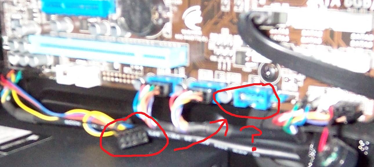

About the microphone port I couldn't really see which cable it was but I've found a lone cable and an extra port on the motherboard, do i need to connect the wire circled in the picture below to the port circled in the picture below? (not really sure what it's for)

Please follow the cable back and see where it leads to. I can't see it very well from the pic, but it does look like a front panel audio cable. Don't forget though that most cases have two front audio connectors, one for HD and one for analog, and we only connect one, so you probably don't need to worry about this.

It seems to lead into the top section where the fan controller and other ports are, I can't see directly beneath that part though so I'm not sure which specific thing it's coming from.

I wouldn't worry about it, it's prob the analog audio connector. If the shorting is still occurring on the HD audio, you could perhaps try swapping them to see if the problem stops?
For the love of god no!
That is as PCS suggests the analogue front panel audio connector or AC97, and the port you circled would happily send voltage down it.
Bad burning fire bad.
