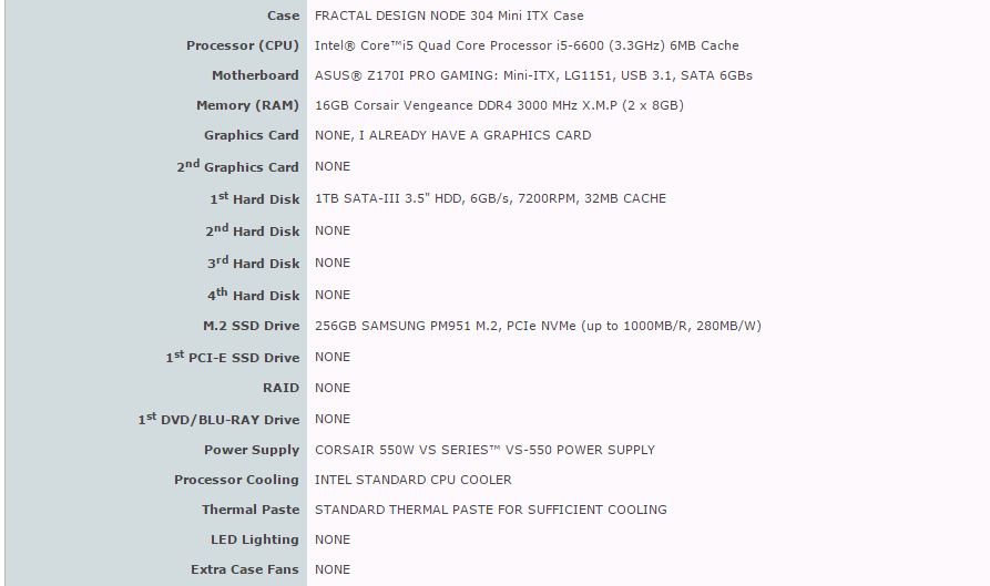

Hi everyone,
I'm currently looking at building a mini PC, using the FRACTAL DESIGN NODE 304 Mini ITX Case.
I'm thinking of buying my a cheap 980 or 980Ti as the Pascals are on their way, so I was wondering what size graphics card this case can hold?
Also, could anyone have this case give their opinion on the airflow of this case?
Thanks all :eek:

If you can add it in the configurator then it shouldn't be an issue, you can also check dimensions of GPUs from the manufacturers website
Oussebon
Multiverse Poster
Though bear in mind that if you add a GTX 960 (or whatever) in the configurator that won't mean that any old GTX 960 will fit, it just means the ones PCS use will fit. Some 960s might be longer, some might be shorter.
Graphics cards, up to 310mm in length, when 2 HDD slots (1 HDD hanging bracket total) are removed (Graphics cards longer than 170 mm will conflict with PSUs longer than 160mm)
http://www.fractal-design.com/home/product/cases/node-series/node-304-black
And to answer the next question:
Dimensions 150mm x 86mm x 140mm
http://www.corsair.com/en-gb/vs-seriestm-vs550-550-watt-power-supply
