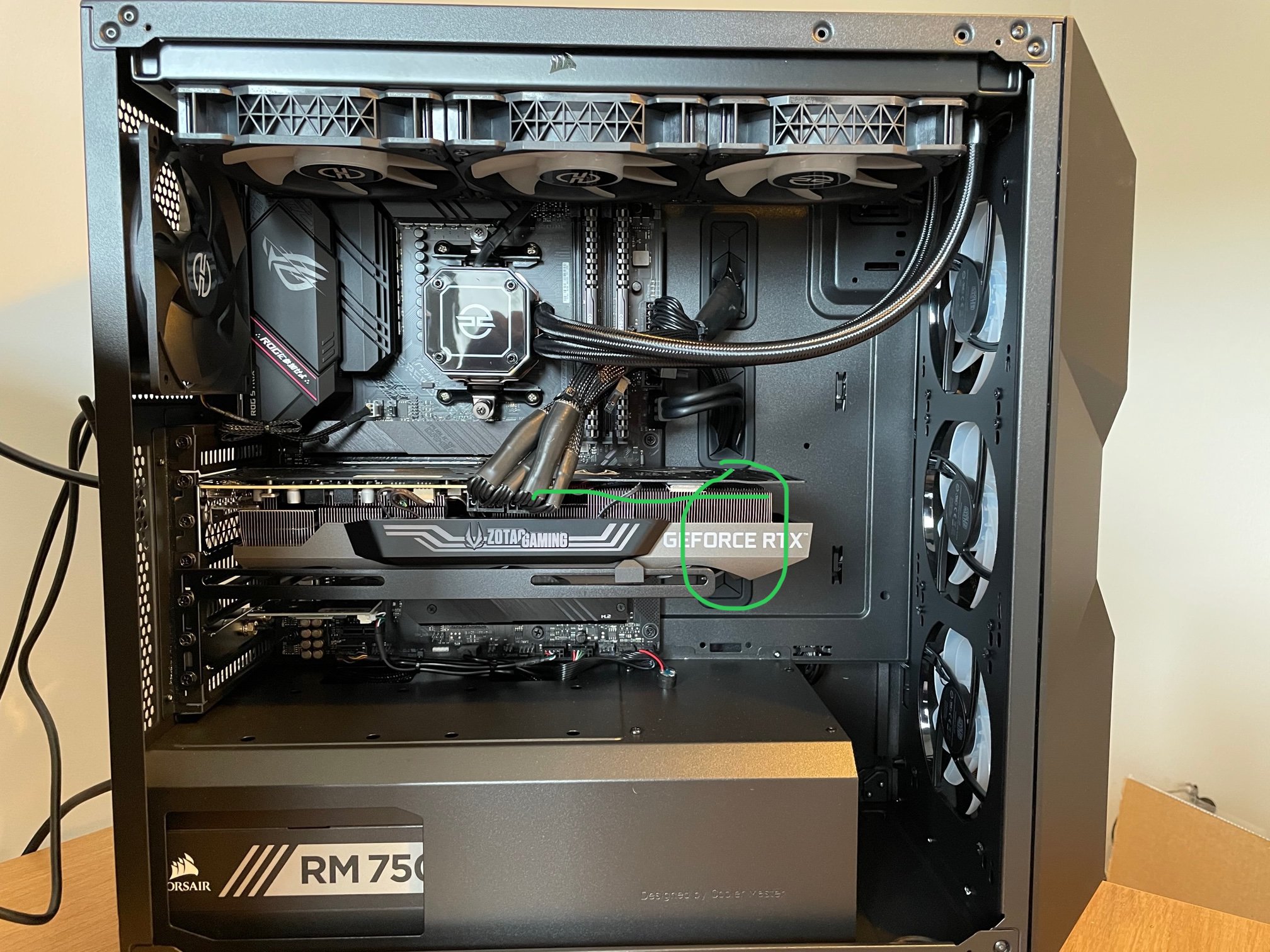

While I’m very happy with my build, one thing that did catch my eye when it first arrived was the big “knot” of cabling for my GPU:
The appearance is not helped by the PCIe cables having two connectors, so the spare connection on each cable is cable tied back on itself, adding to the bulk.
I’m considering buying this which just has a single connector, which will streamline the mess a bit. But I’m wondering if I could route the cables from the bottom grommet (circled in green, behind the GPU), but run parallel to the length of the GPU, so as not to block the RGB on the front/top of the card
Do people think this might work, or will the angle be too severe for the cables?
Also, will the new cables have enough stiffness to shape them so they don’t sag onto GPU? I’m thinking having cables touching a hot surface is not ideal.

I had the same issue myself with the double ended and stiff, hard to route cables packaged with Corsair PSU's. Also did what you did, buying new cable (though I got the whole kit; two 8 pin power, as well as mobo, CPU cable etc as the mobo one was thick and stiff enough to actually bend the frame where it routed through from the cabling area on my case... some extra cable combs also helped keep things steady and neat)
The new cables, while way more flexible, allowing me to route them under the GPU up rather than arced over and down, are probably too flexy to run against gravity or any nearby bends without recourse to some kind of fixing medium... cable ties, velcro strappies etc (though you do have a GPU bracket that might help as a tethering point) Those are a good investment though in your case it's unfortunate that the main RGB/logo area is right under the sockets. As for running them through that grommet, that'd work for leading them in under and out of the way but you might still need a way to run them so they stay put where you want them.

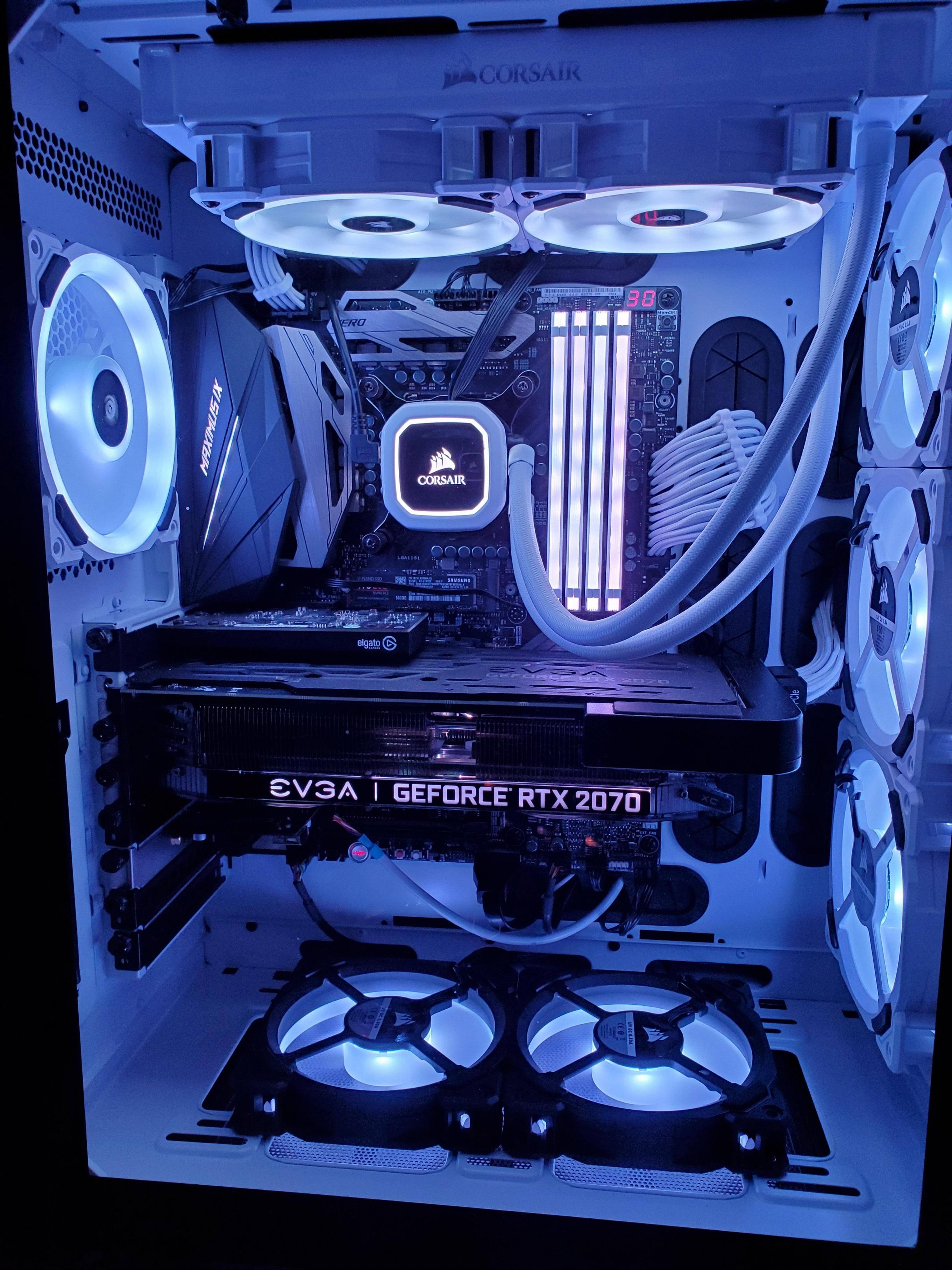

I had same issue. I ended up buying cable extensions. I can tell you. It looks 1000x times better. This is what my system looks like with cable extensions.

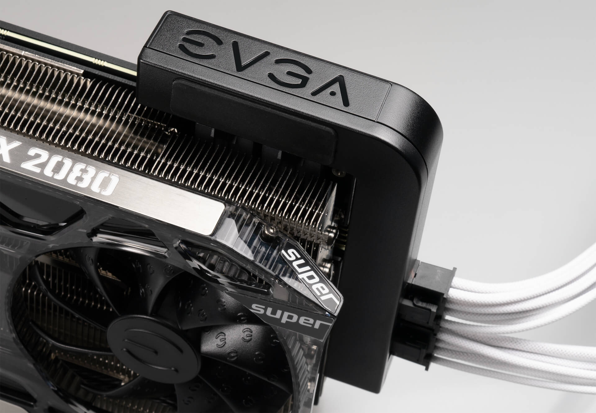

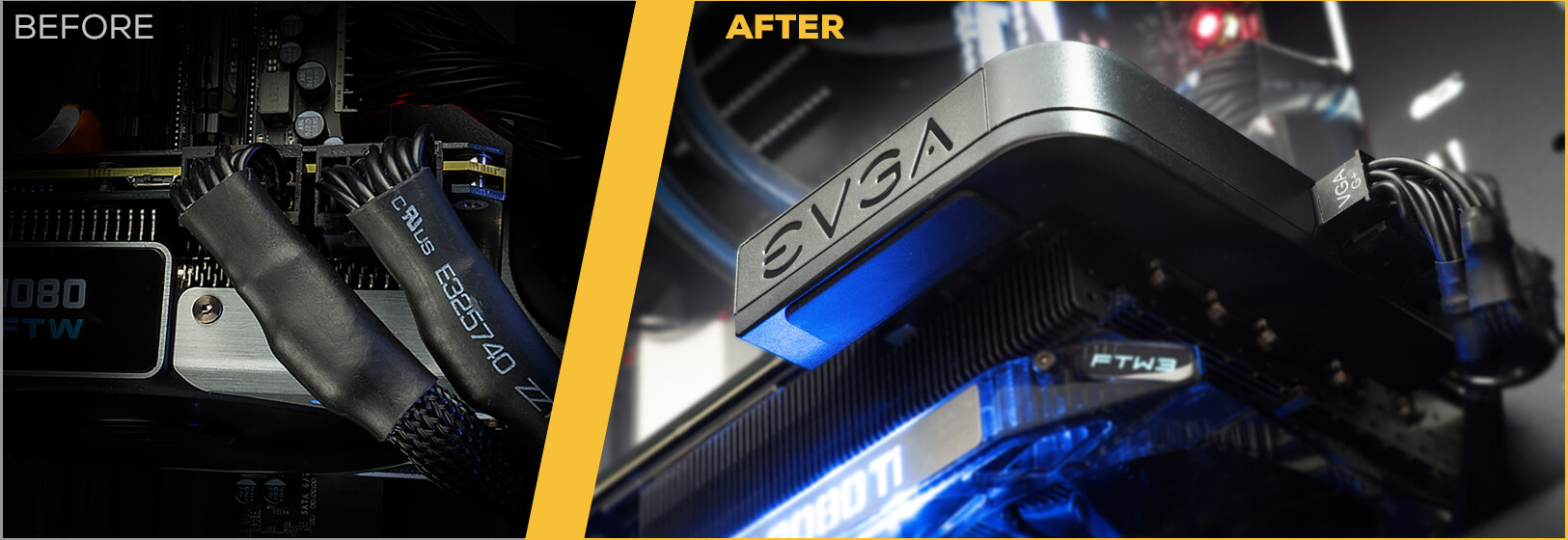

It seems you could do with a product like the EVGA Power link...
But only if there was different / more variations, as i know this won't fit on the 3000 series cards due to where the GPU connectors are, and it may not be suitable for smaller cases if you have a longer GPU, but something like this would seem to be ideal.
It does give a much cleaner look...

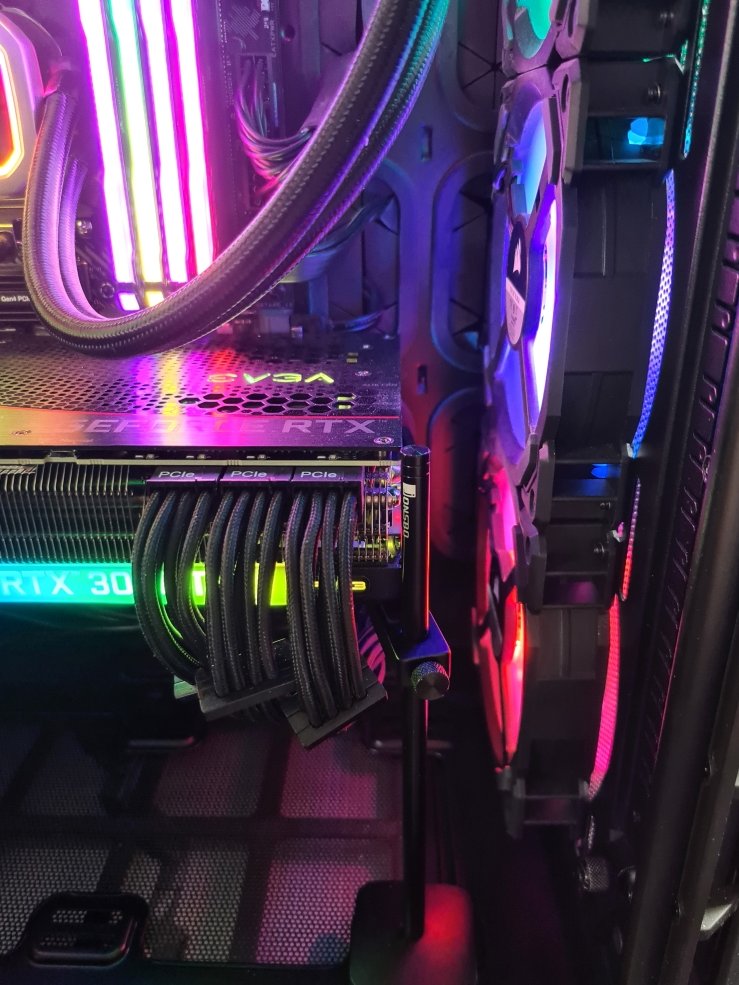

I wish that was my PC, but unfortunately it's not, I googled a PC build image with the EVGA Power link in use, and that's the cleanest one i found just to show it off what it looks like,
Here's mine, It's not as clean as that white build, though i do have the same case "Corsair Crystal Series 680X" in black...
If EVGA did have a Power link to fit the 3000 series card, it wouldn't fit in mine, My 3080ti is just to big and long as the EVGA Power link would be right up against the front fans and no space at all to plug in the PCIe cables,
My cable's are running underneath the GPU, and i have no fans on the bottom of the case.

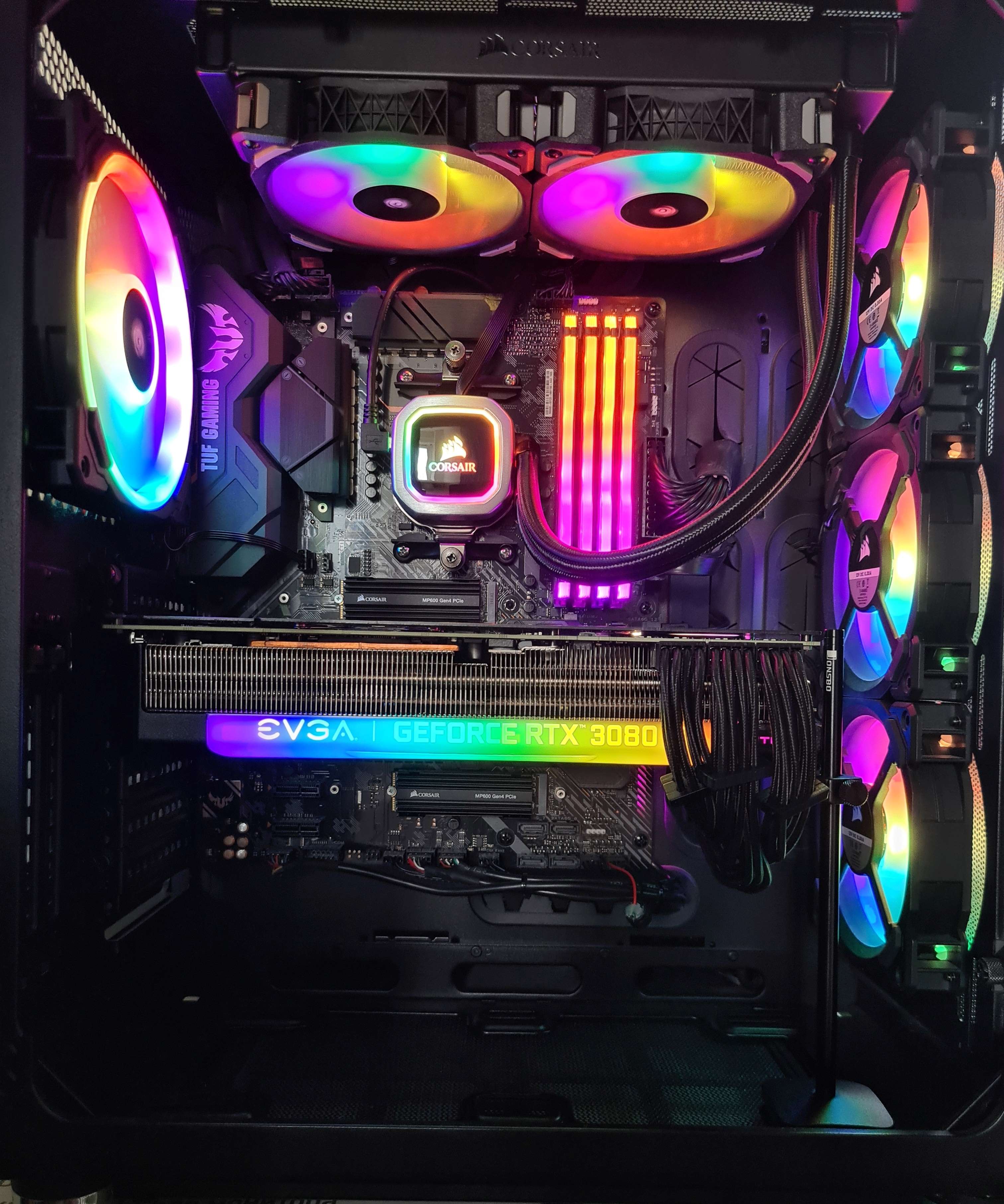

To update on end result: I went ahead with the Corsair PCIe cable option, and routed them up from the PSU shroud/basement up to the connectors on the GPU. Obscures the RGB on the card a bit but I felt it was the neatest approach, given the placement of the connections relative to the grommets etc.
The only negative to the Corsair cables was that they only came with a single comb, so I ordered a pack of Akasa black cable combs which fit well. Happy with the end result.
