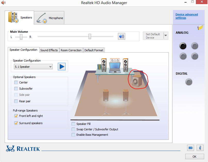

I have similar issue. All virtual speakers play demo sound except from virtual subwoofer when I use stereo headphones:
a) My stereo headphones are connected to “Front Speaker Out”.
b) Speaker configuration is set to “5.1 Speaker”.
c) All Speakers on “Optional Speaker” group box are disabled which means that they are virtual speakers and all of them must play on stereo headphones:

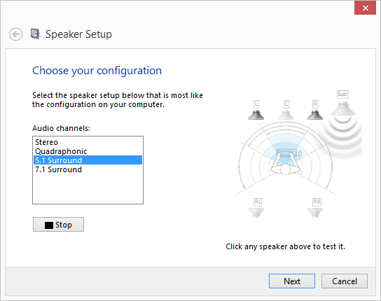

Screenshot of Microsoft Windows version of same setup:
When you left-mouse click on subwoofer icon same problem occurs: virtual subwoofer is not producing any sound while play animation is showing.
I’ve tried exactly the same configuration with external USB “SoundBlaster Xi-Fi Surround 5.1” and all 5 speakers + 1 subwoofer play demo sound perfectly trough stereo headphones: 5 ding sounds and bass sound for subwoofer.

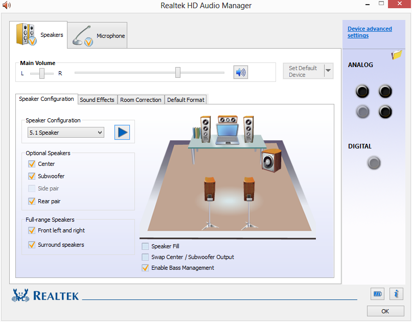

Note: Centre and Subwoofer sound test works through real speakers if I plug them into "Center/Subwoofer Speaker Out" socket:

I have found source of the problem and workaround which worked for me. It is a bug in "Realtek Sound Manager" software.
First, in order for Virtual Subwoofer to work
a) "Creative THX TruStudio Pro" must be installed and activated.
b) "Speaker" option must be enabled.
How to replicate bug:
a) Open "Realtek Sound Manager"
b) Change Speaker configuration from 7.1 to 5.1 and back to 7.1:
Result: Virtual Subwoofer sound will be gone forever.
