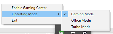

Right clicking the icon, you get a menu - clicking Enable Gaming Center - opens it - I will explain the Operating Modes later that you see here:

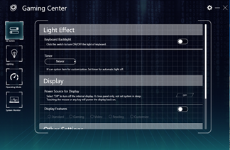

First button at top is EZ Switch - basically some quick settings that you can use - as you see on the screen shot above - this has:
Light Effect:
Keyboard backlight
- turn on and off the LED on the keyboard - does exactly as it says. The Fn + F6 and Fn + F7 function keys adjust the brightness, but can also be used to turn on/off the lights.
Timer - not sure why you would want a Timer, but you can set this from 10 seconds, all the way through to 'Never' and it is a basic timer for how long you want the lights on for on your keyboard.
Display:
Power source for Display
- this turns off your screen not quite sure why you would want it - its not a sleep mode and basically as soon as you touch your mouse or keyboard again the screen comes back on - I suppose some people may have a use for it.

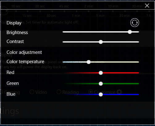

Display Features - this is various Display (brightness / contrast) and Colour adjusted (temperature, RGB) modes - you have a choice of Standard, Gaming, Video and Reading presets, plus a Customize - when you have selected one a cog appears (except on Standard) which you can press to adjust as per the following screen shot:
Other Settings:
Windows Key Lock
- this enables / disables the keyboard Windows key - quite useful if you accidentally keep pressing it in full screen games. Can also be toggled by pressing Fn + F2.
Hibernation USB Power: when this has been toggled on, your USB port will remain active when the laptop is powered down or in hibernation mode. Quite useful, for example, if you leave your phone plugged in to charge when you are not on your laptop although be careful as will drain the laptop battery if you havent got your machine plugged in.

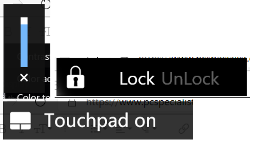

Turn off OSD: this toggles the little on screen display on and off that you get in the top left corner when you put volume up, down, brightness, turn on/off the touchpad, numlock on and off etc, a few examples shown here:

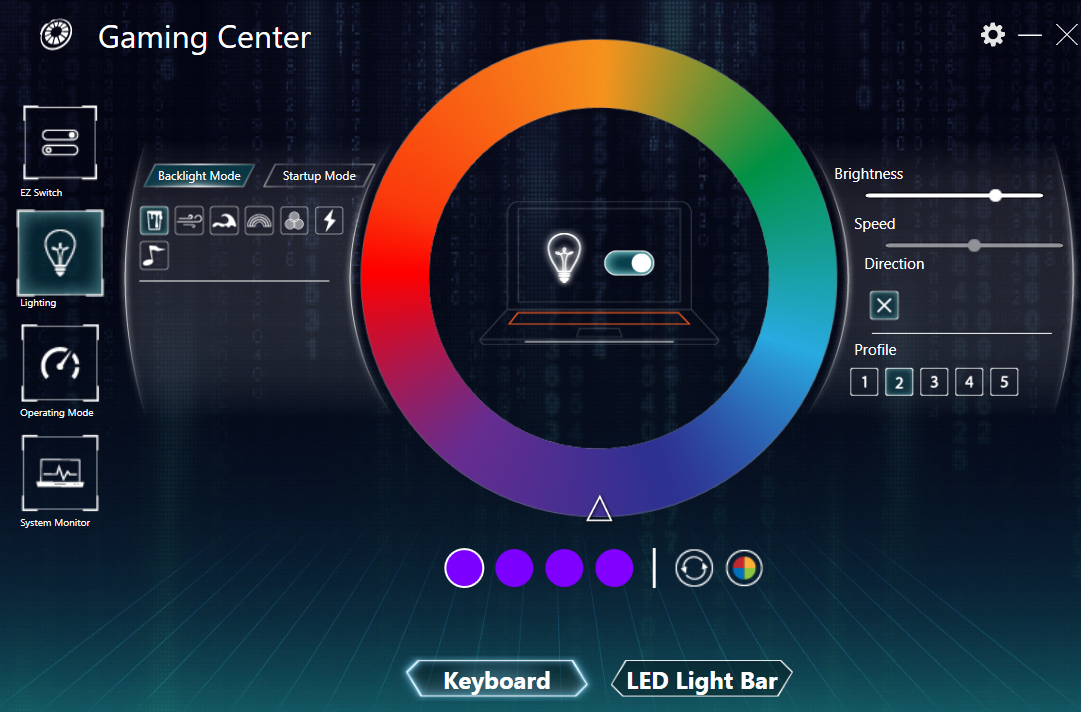

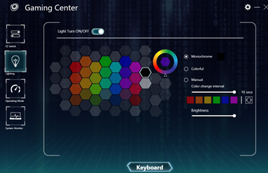

Lighting:
This is where you change the colours of your keyboard LED lights - you only get the same colour applied to all keys - there is no function in this GamingCenter to choose different colours for different sections OR individual key colours. The choices you get are as per the screen shot below (30 colours, including black and white).
You can select
Monochrome - A single colour - select from the colours on the left.
Colourful - this periodically changes between several colours (possibly all of them, I haven't actually looked at it long enough to see how many it scrolls through)
Manual - You can choose 6 colours, that it will 'scroll' through at a timed interval for each colour - which you can set as 2, 4, 6, 8 or 10 seconds
Brightness - as it says - this is the brightness level of the LED lights on the keyboard. Can also be adjusted by pressing the Fn + F6 and Fn + F7.

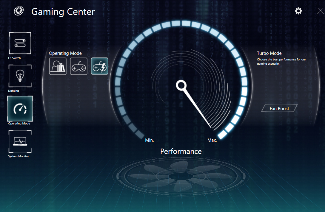

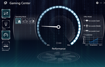

Operating Mode:
Basically - FANS. There are three ways (on the Optimus Pro laptop) to switch between the three preset modes - in the Gaming Center, right clicking the icon - as pictured earlier, or pressing the button to the left of the power button that has the 'rev counter' type icon on it. This cycles between the modes.

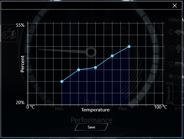

Office Mode (less fans, so quieter - but not ideal to use when gaming - hence the name):
Basically, this is the slowest fan speeds usually and you have choices on the right hand side for Quiet, Middle and Loud which again just changes the 'curve' you see underneath - the curve indicates the %age of speed of fans ('y' axis) that it will run at, if the temperatures ('x' axis) are reached.
You can also 'Customize' - albeit this just enables you to move the dots up and down (not left and right) for the five temperature settings:
Office mode also has an Eco button in the middle of that big dial too - less power usage.

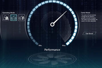

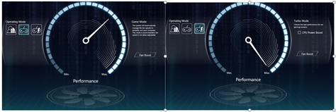

Game / Turbo modes:
The system will automatically adjust your fans as it sees it needs to. You can not adjust this mode - its an automatic mode that base don the temperatures of your CPU and GPU, the fans will kick in and get louder or when cooler, slow down and be quieter.
There is a Fan Boost mode to this - which basically sticks the fans on full blast by the sounds of it - not sure if there is a fast-key way of putting boost mode on.
Turbo mode increases the performance of the fans and speed higher than normal gaming mode - so if you play some intensive games where the temperatures do get hot quickly and you can bear a bit, ok a lot, more noise from the fans, then you may be better having it in this mode to help with the cooling.
There is also a CPU Power Boost to toggle on / off for Turbo mode.

  1. The color picker is different, plus missing the white colour;
  2. there's no CPU boost button in my application.
My system is a Vyper III with i7 10875H.
Is it depending on the model of the laptop?

Bhuna50
Yes sorry, it is likely that the differences are chassis related - I have the Optimus IX Pro.
I have put a sentence in the first post so people are aware there may be some differences.
