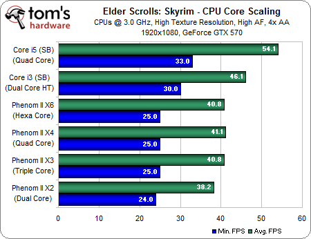

The GTX 570 would be fine but, as Dangro474 suggested, your CPU may bottleneck the GPU. You need at least an i3 to get a minimum of 30fps at high settings but an i5 would be ideal.
