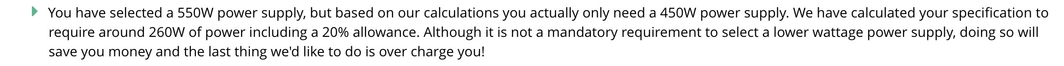

Is that going to be an issue? Whenever I selected something higher they kept saying "you don't need it. You only need around 220w"
Something to that effect anyway.
This is what I see, whenever I even go to the next one up.
Unless you mean light quality/price wise?
