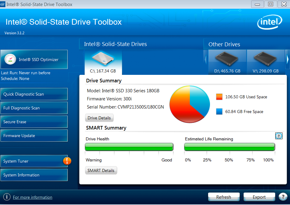

HAve you installed the Intel SSD Toolbox? Here's hopefully what you will see there:
I researched much befire investing in the SSD and found that on balance a spinner would fail quicker than an SSD. I assume you have Trim enabled and auto defrag disabled?
Thanks for this, keynes put me on to the toolbox (post #5). Yes, TRIM is enabled and autodefrag is off.
