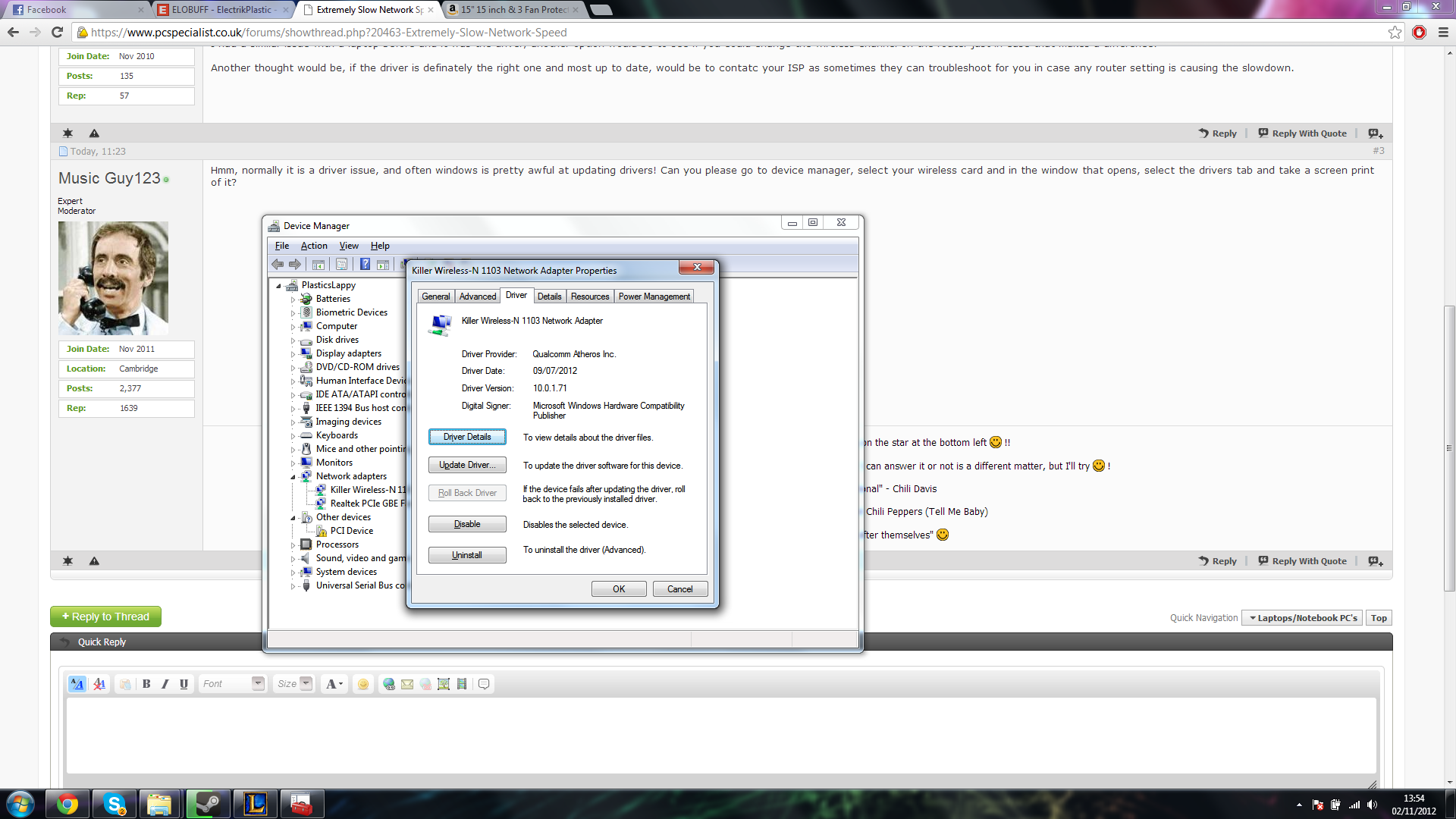

Hmm, normally it is a driver issue, and often windows is pretty awful at updating drivers! Can you please go to device manager, select your wireless card and in the window that opens, select the drivers tab and take a screen print of it?

It just took me 6 attempts to upload that picture. Steam is downloading at around 100kbps, when my PC gets at least 1000, sometimes up to 2500.

Hmm, interesting, looks like that is probably the latest driver. Have you tried installing previous drivers maybe one or two previous ones?
Probably won't work but I looked at the killergaming website and went through the drivers available, they are saying the latest one is 6.1.0.395. Have a look, it may not work but maybe try giving it a try? http://www.killergaming.com/support/Downloads?category=5&model=121&download_type=1&os=7
