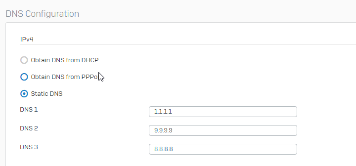

I didn't know they had a free - let alone free and secure - offering. Thank you for that.
My gateway now points to 1.1.1.1, 9.9.9.9 and 8.8.8.8 as the preferred order :)

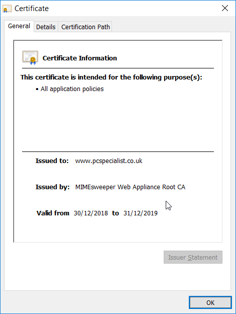

In terms of BT not seeing into the traffic - don't bet. They used to use a transparent proxy, including a man in the middle (MITM) certificate and appliance. Though it's worth noting that I understand they stopped this practice some time ago, it meant that no matter what DNS servers you used, your DNS queries ultimately always went via BT and the MITM approach meant they could decrypt any SSL traffic.
It's very common in the workplace- you can tell if you look at the certificate of a secure site. I am connected at work and look what the certificate says is for https://www.pcspecialist.co.uk:
It's naughty and it's difficult to do outside of a corporate organisation without notice nowadays. It can also break if you're setup to use certificate pinning, but that isn't normally adopted much.
The main difference here is the proxy server isn't transparent so I can see easily there's something in the middle. Not so much when the proxy is transparent.
