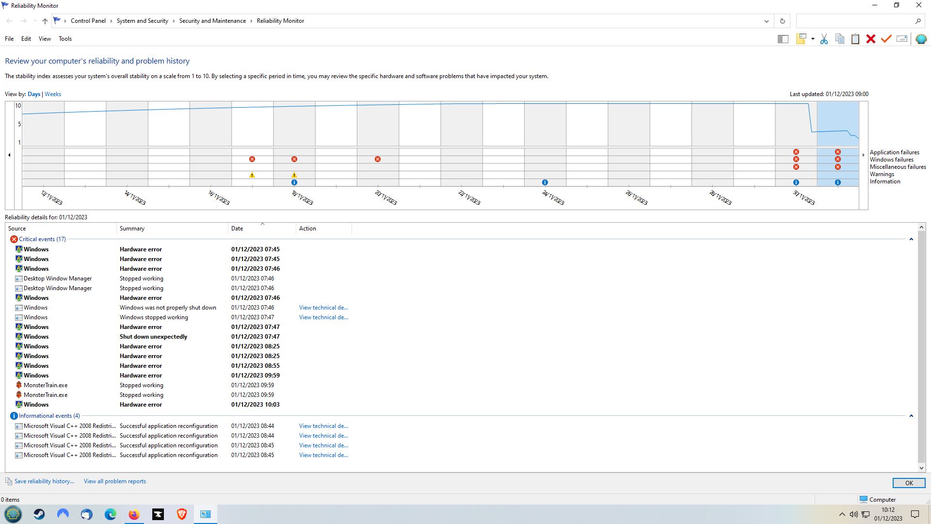

Looking at my reliability monitor i get

I've now uninstalled the graphics driver again. I'm using the microsoft display basic adapter in device manager. no crashes.

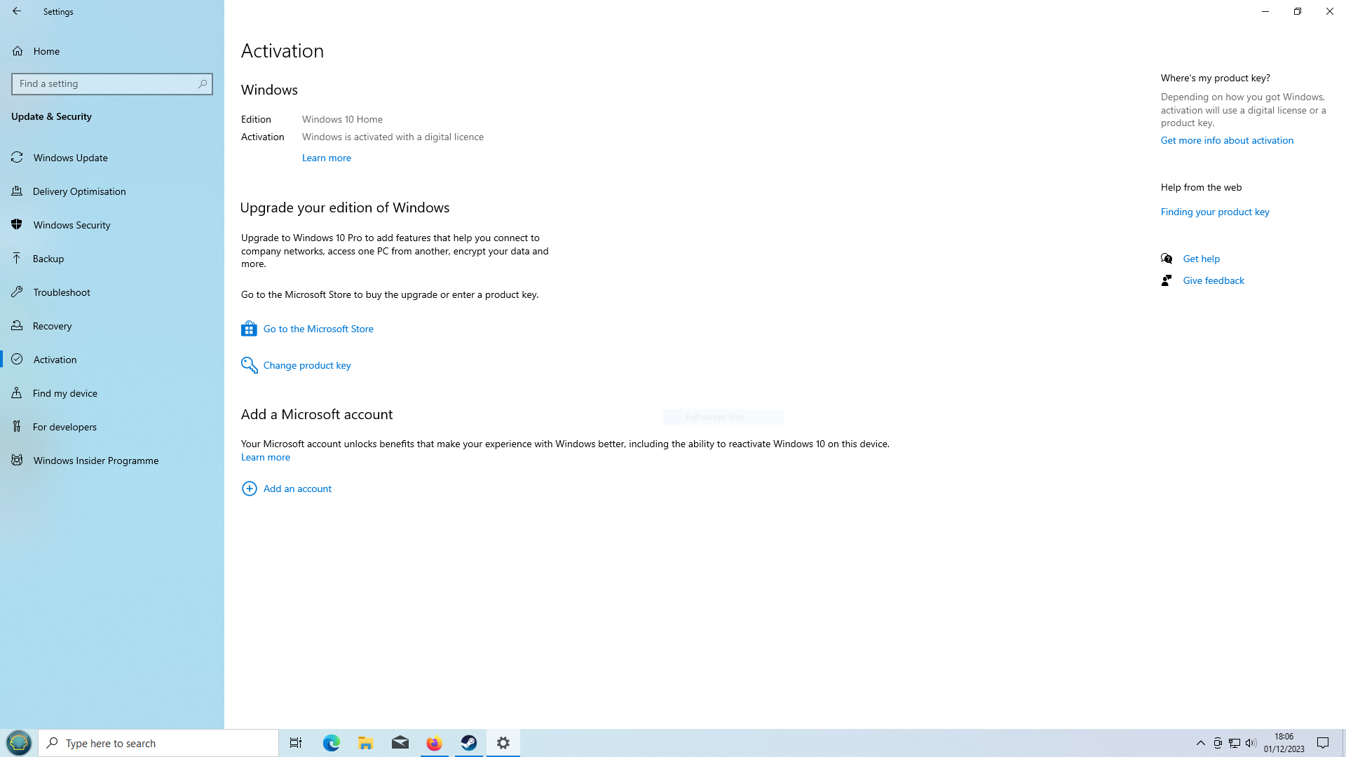

Does make me wonder what version of windows 10 it’s on, if it’s an out of support version, if perhaps it’s not been receiving further updates which has left the OS compromised.
I always expect the worst in any given situation, I very much doubt this is the case, it’s just the first thing my brain goes to

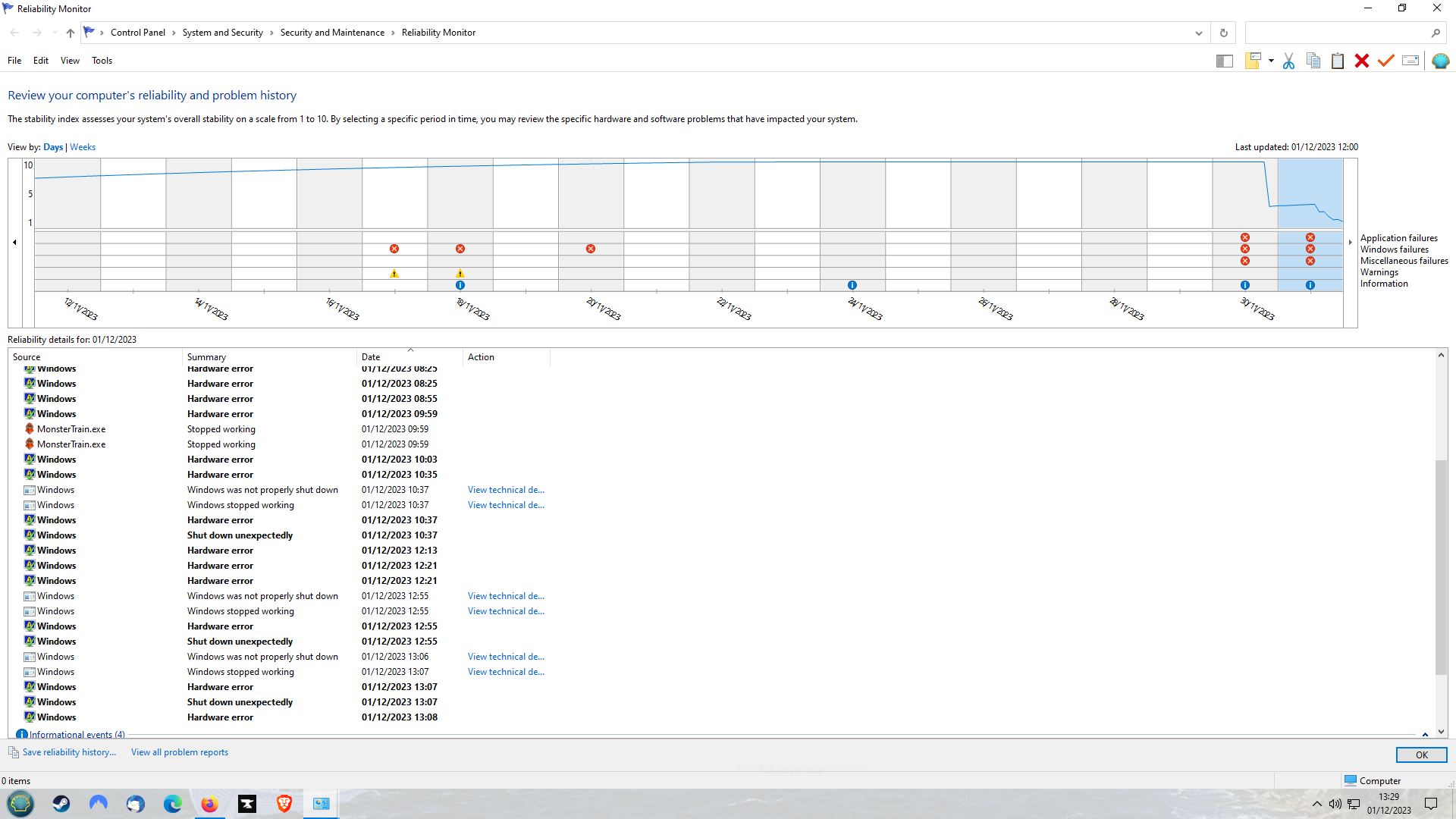

When this popped up after the last crash i was ready to pull my hair out lol. I just removed the drive from the computer and reinstalled windows on the m2 ssd. ive installed the latest driver for my gtx 1080 and am now downloading games from steam to see if finally no more crashes. /crosses fingers
