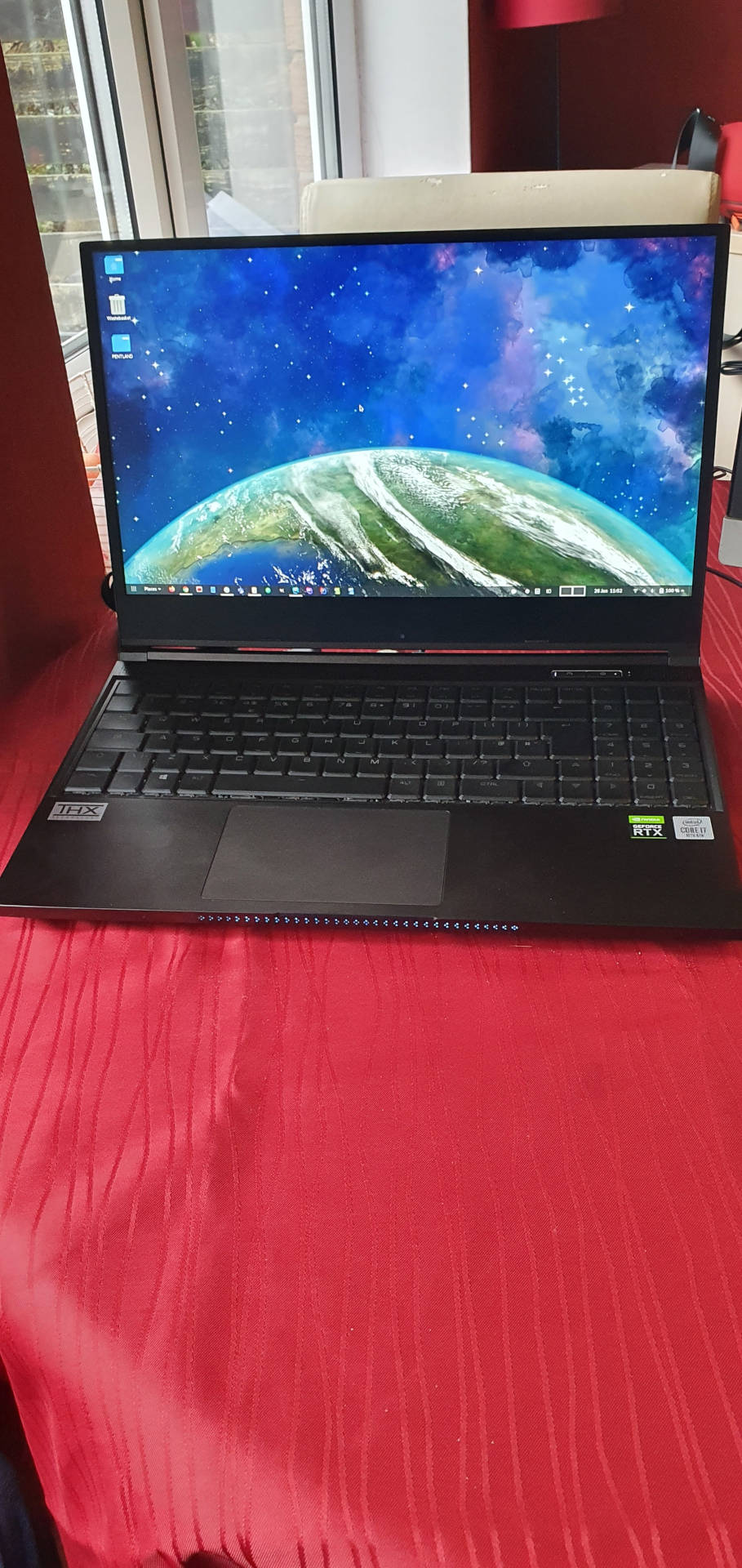

Ordered the laptop, no problems, came early compared to the original quoted date and was packaged really well :)
I ordered without OS so I could install Linux Fedora 33 but was expecting to have way more problems than I actually had with the Linux setup, especially considering the disk setup I wanted.

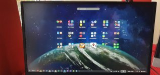

So I have managed to install Fedora 33 (Latest Gnome 3.38 customized Shell theme, Shell Extensions and Icons).

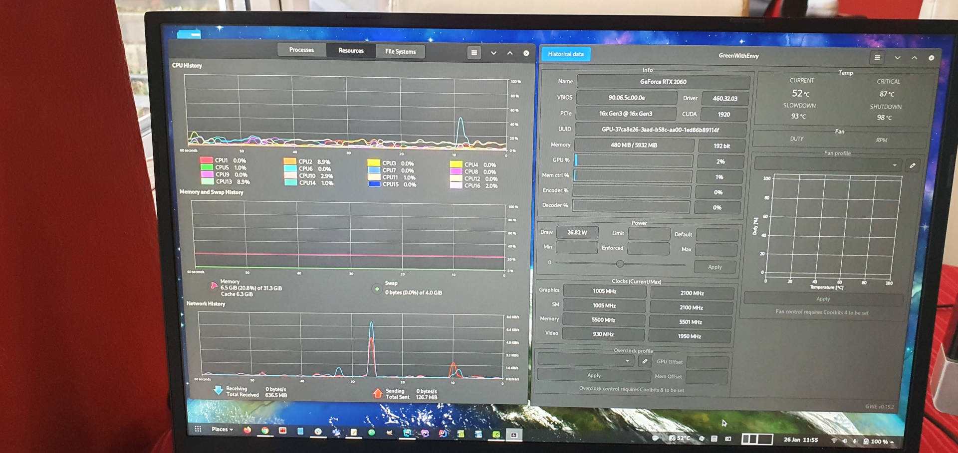

I have 2 X 500GB SAMSUNG 970 EVO PLUS M.2, PCIe NVMe (up to 3500MB/R, 3200MB/W) SSD's setup with Latest Btrfs File System, Linux Software RAID 0 and LUKS 2 Drive Encryption.
All hardware so far seems to be working fine under Linux including the RTX 2060 Nvidia GPU which I did remove the default nvidia nouveau driver that comes preinstalled with Fedora 33 and replaced with the Propietry NVIDIA-Linux-x86_64-460.32.03 Driver which seems to give less fan noise. Further testing on that to come.
WIFI / NIC -> WORKING
Bluetooth -> WORKING
Thunderbolt 3 -> WORKING (Not tried Monitors)
Sound Card -> WORKING ALTHOUGH SOUND NOT GREAT NOT SURE THX etc working fully (Would need to compare with same laptop on Windows)
Headphone Out - WORKING
Microphone -> WORKING
Webcam -> WORKING
HDMI External Monitor -> WORKING (Not tried yet multiple screens via Thunderbolt but will report back on that).
So far the only thing I haven't been able to get working properly under Fedora 33 is the RGB Keyboard functionality. The BIOS seems to disable the RGB lights on the keyboard on a regular basis and I have to go back into the BIOS to enable again. This gives me Solid Red on Boot due to selected option in Bios which then turns to Rainbow on entering the Desktop Login Screen. I can then use the function F6 & F7 to change the brightness of the RGB Keyboard up or down. I can't however change colors schemes at the moment. I did find some instructions online in regards to this but it involves installing a Kernel Module etc etc which apparently then allows you to change Colours on the Keyboard using Function /. If I can get this working to any degree I shall report back with a walk through for other users. I was also looking into running the Windows Game Center App via Wine in Linux but no joy yet although I did get it to install.
