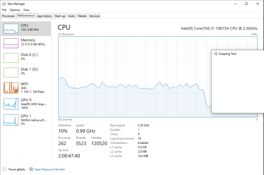

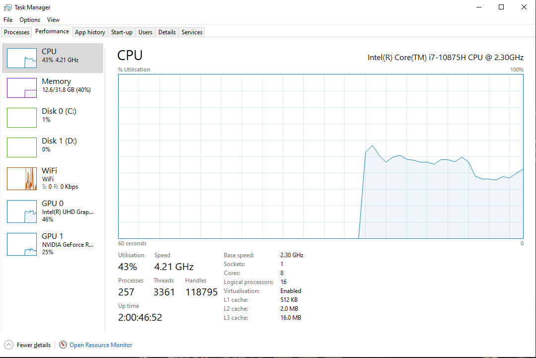

That is possible, how would I check that? Here's my performance plugged in:
And here it is on battery:
Ok so that does look like the dGPU's use drops a lot... How do I change it so that doesn't happen? Also, the CPU dropped to 1 GHz, but I have the settings to be on 100% min cpu state...

It does look from those screenshots that the dGPU turned off and the iGPU maxed out. But something is throttling your CPU too.
