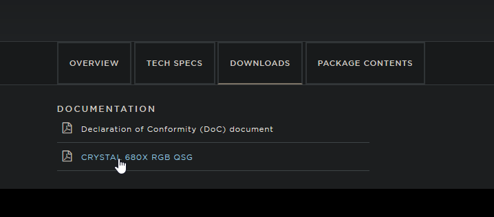

If you go here:
Go to the download tab, then you want the option here which is to download the manual and it's page 6:

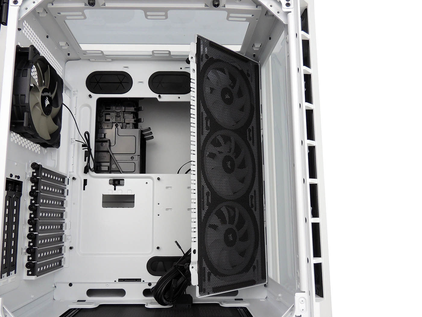

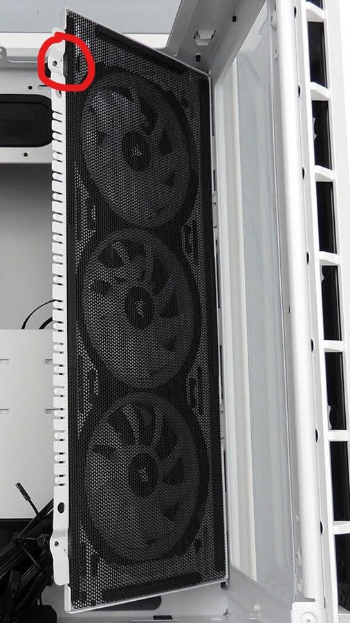

The filter is magnetized to the door that swings open,
If you can get the door to open just slightly, you can just about be able to pull the filter out and away from the door,
the red circle I've marked is the easiest way to get and pull the magnetized filter out as there's a notch to get a hold of the filter, to be able to get it out and clean it.

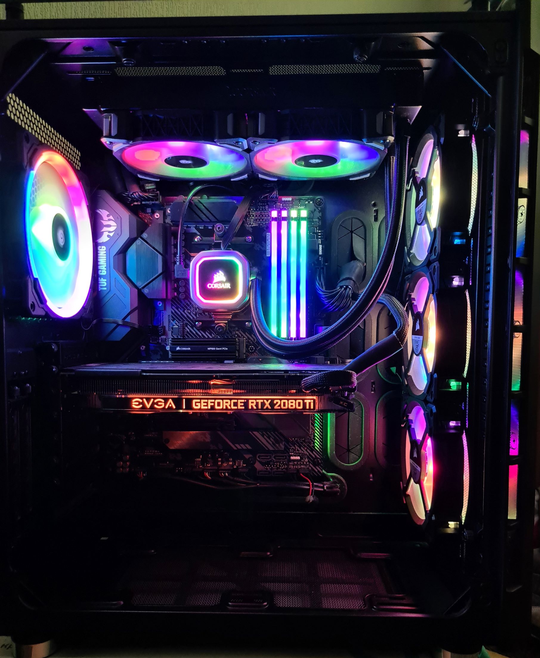

This is my PC and I don't have to remove anything to get my filter out to clean,
I may not have fans on the bottom, but there's still enough room for me to undo the thumb screws and open the door just enough to get to and remove the filter,
You shouldn't really have to remove anything to get the filter out, though removing the GPU can make it easier for more space,

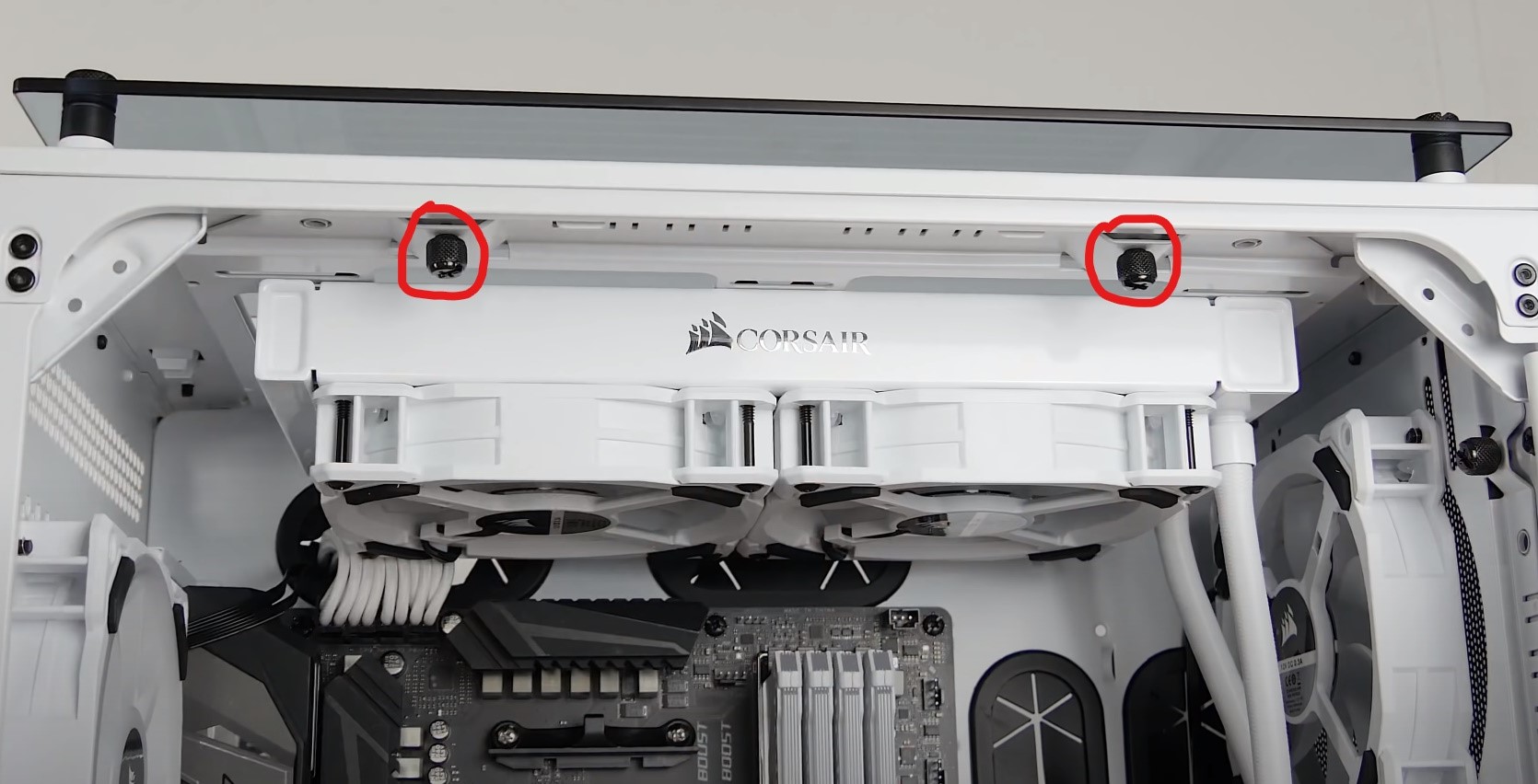

You could try to remove the radiator from the top of the case by undoing these thumb screws but you will most likely have remove/disconnect the radiator fan cables, to get the radiator out...
Doing this, allows you to get to the filter just above the radiator, to give it a clean if needs be, which will then give you better access to the front fan filter as the radiator will be out of the way to open that front fan door,
You will have to remove your GPU just to have more space to work in/with.
