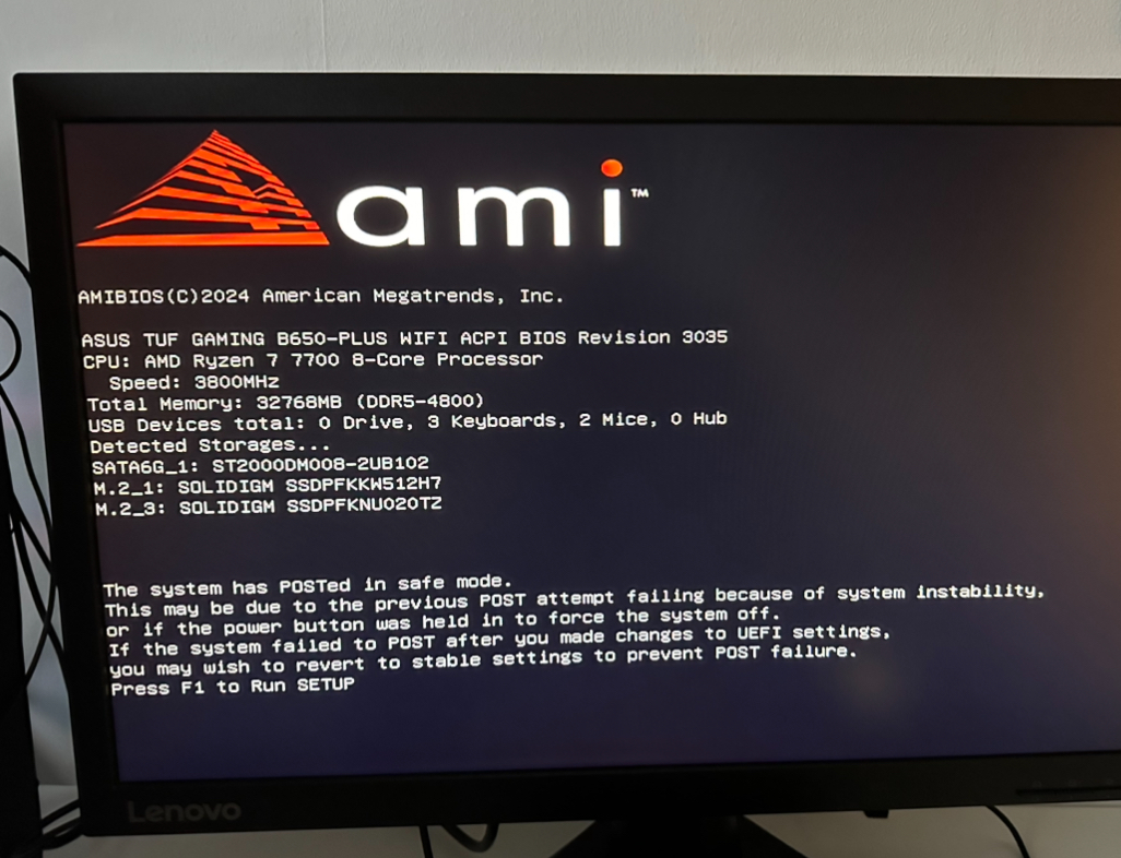

I should have heeded the warnings but I really wasn’t expecting this.
I installed armoury crate but I changed my mind after reading about openrgb . I then tried to uninstall but it said install failed and I had to restart. Now I have this screen.

Just a failed restart as it says, just boot as normal.

Yes just a failed restart. Great when it takes hours to figure out how to turn off a light... Probably quicker to install a new cooler.
