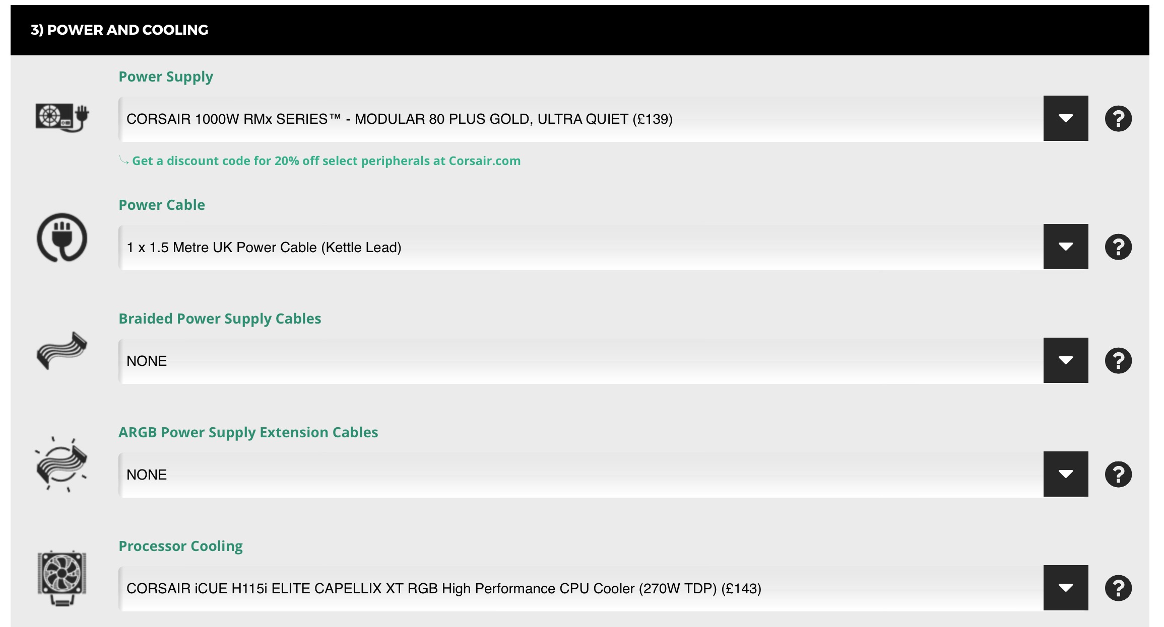

Does anyone know how I add it to the build on the configurator - or is it something I have to get separately? - and if so, do I need to get a specific one to match my case?
Boydie
Perfecto! @TonyCarter - and I noticed that @Scott had already added to the recommended spec 👏👏👏👍

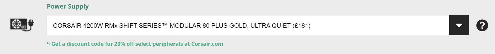

Well, if you're happy to spend a few more £££, then the only further recommendation I'd have is to go for the newer ATX3 spec PSU (RM1200x Shift)...which should give you plenty of headroom for any future GPU upgrade, and makes cabling a little easier as the sockets are on the side instead of the back.
No point in any aesthetic stuff, as you won't see it anyway.
