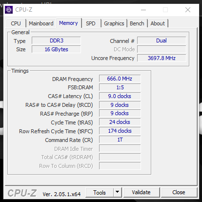

I've tested switching out the RAM and it boots fine for both.
CPU-Z is showing the following readings - not being an expert I don't know if the variances are material enough to be causing an issue with incompatibility
And yes, I'm aware the CPU is old and there is probably very limited benefit for what I'm using it for (video editing and gaming emulators :D) but TBH I figured I'd try it as the RAM was super cheap and some of the programs were lagging.

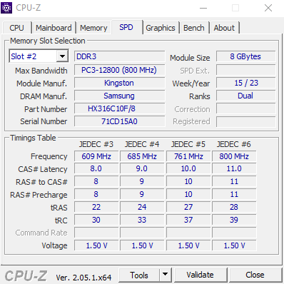

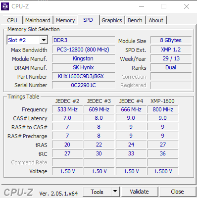

Hi.
Finally had chance to do this and voltage on the sticks is the same - differences on other elements - see attached images
