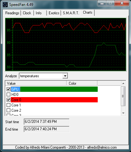

Thanks for your response. Here's a graph I got quickly. There does seem to be some throttling when I play a game (in this case, Watch_Dogs on lowest settings). Also I just realised how worryingly high the CPU temperature is, even when it's idling at 25%... Is there any way to cause the fans to go perma-boost, cause I'm really not that fussed about the noise.

Looking at those temps you are definitely experiencing throttling.
I don't think there is any way to manually run the fans at full speed but with the temperatures in that graph they should already being doing so on their own. If not then that's your problem which could have been caused by the water damage.
If you think the fans are running at full speed then you either have a problem with your heatsink , thermal paste or which is the most likely issue, a build up of dust between the fan and the heatsink. Is the air the laptop blows out hot? I'd be tempted to open up the laptop and check for the dust build up. Although some people recommend using compressed air from outside I don't think it can remove the dust properly once it has built up to resemble a carpet on the heatsink. Also when using compressed air people don't realise that it's important not to spin the fan with the air as it can act like a dynamo and apply rogue voltages to the motherboard. For that reason I think it's better to physically open the laptop up and inspect.

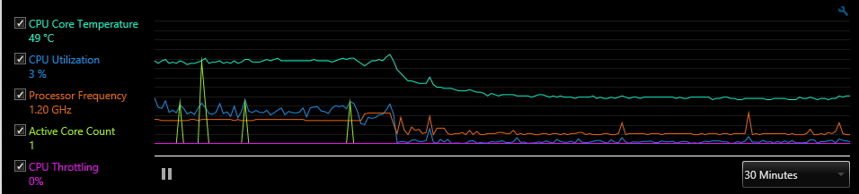

Edit - It's your CPU which is throttling at over 95C. Using Intel Extreme Tuning Utility you can get a graph with this sort of information which will confirm it.
It's the purple line which is important. My CPU speed is only low here because it's not being utilized fully, not due to temperatures.

The program wouldn't let me show anything on the graphs other than CPU Usage and Processor Frequency, but when I ran the stress test, the CPU throttling went to around 50%. I'm going to take it apart and look for dust buildups now. Thanks for your help!

No problem. If you want to customise the Intel Extreme Tuning Utility graph then you can do that by clicking the spanner at the top right of it. I must have done that a while ago and that's why mine shows throttling as well.
