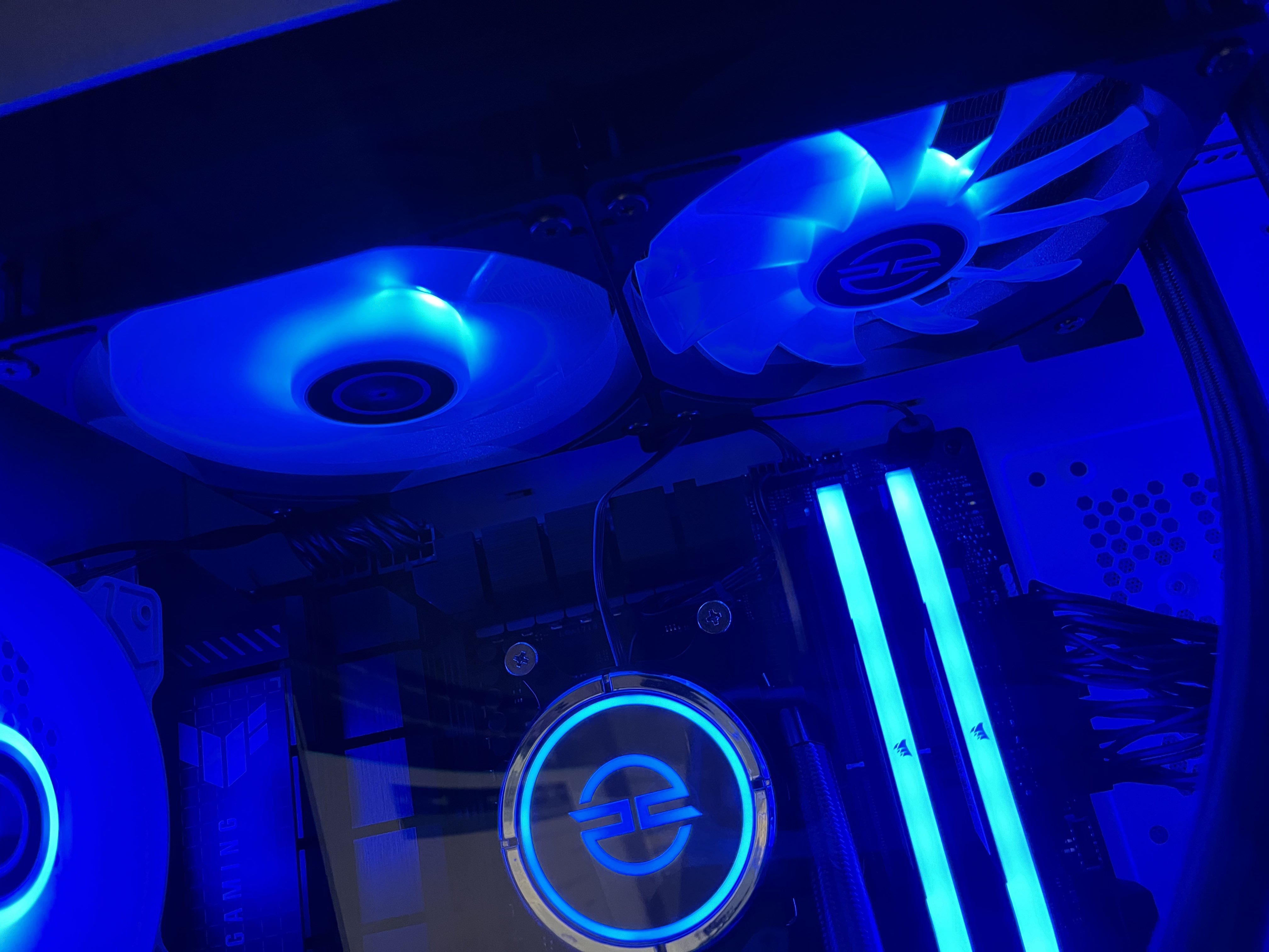

1 of 2 CPU fans are no longer spinning
Signature_T
The lights are on and everything, the other fan just doesn't spin, however it did work fine for my first week* on this pc (I say week, it might be a bit longer now)
Make sure everything is plugged in properly, so remove the GPU, put it back in and check the power leads are firmly connected at both ends
B4zookaw
Don't think there's a need to remove the GPU, but take off the side panel and see if you can trace the cables from the non working fan back to where they connect to either a splitter cable, or to the motherboard. It could be a connection came loose (ideal, easy fix) or the bearing on the fan has failed (in which case it will need to be removed and replaced). If PC is under warranty (less than a week old) PCS will supply new fan for free.
B4zookaw
Yep, the two AIO fans on the top of the case, one is spinning the other is not. I'd assume PCS connected both fans to a splitter and then to the CPU_FAN header, so hopefully it's a case that one of them has shaken loose from the splitter.
